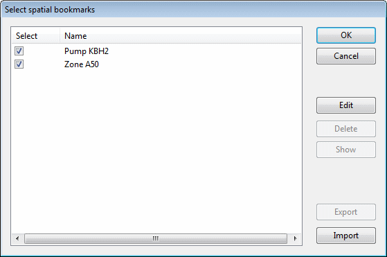

This dialog is displayed when using the batch print functionality from the Print Layout View.
A Spatial Bookmark is a named marker that identifies the zoom extents of a particular location or selection of objects. These bookmarks allow the user to jump to views of areas around the network easily. Spatial bookmarks for a network are set up InfoWorks ICM Ultimate or ICMLive Configuration Manager.
The dialog displays a list of all Spatial Bookmarks for the current network. The checkboxes are used to select which bookmarked views to print.
The buttons allow you to manage the Spatial Bookmarks for the current network.
| Button | Description |
| Edit | Displays the Spatial Bookmark dialog for the currently selected bookmark. |
| Delete |
Disabled in the Operator. |
| Show |
| Export |
| Import |
Imports Spatial Bookmarks from an XML file. Displays a standard Windows Open dialog from which you can select the XML file to import. Clicking Open imports the file. Note: Existing bookmarks are removed prior to import.
| OK | Dismisses the Manage spatial bookmarks dialog. |
Spatial bookmarks for a network are set up in InfoWorks ICM Ultimate or ICMLive Configuration Manager. Only temporary changes can be made to bookmarks in the Operator. Any changes made in the Operator will not be saved; the original bookmarks will be restored once the manifest is closed.
