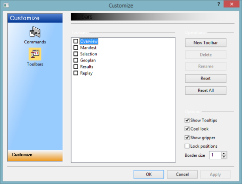

Customise - Toolbars Page
This page of the Customise dialog lists the toolbars that are available and indicates those that are currently visible.
Customize dialog - Toolbars page
This page can be used to:
Use the Commands page to change the contents of a toolbar.
Operations
These buttons are used as follows:
New Toolbar
Creates a new user-defined toolbar.
Delete
Enabled for user-defined toolbars only.
Deletes the currently selected toolbar.
Rename
Allows the name of the toolbar to be changed.
Reset
Enabled for ICMLive Operator Client toolbars only.
Resets the currently selected toolbar to display the contents of the toolbar before the current instance of editing (i.e. before the Customise dialog was opened).
Reset All
Resets all of the ICMLive Operator Client toolbars to display the contents of the toolbars before the current instance of editing (i.e. before the Customise dialog was opened.
Tip: To restore the contents of all ICMLive Operator Client toolbars to their default settings, select the Reset toolbar buttons option from the Tools menu.
Options
These options change the way in which the toolbars are displayed:
Show Tooltips
Determines whether descriptions are displayed below the buttons when the mouse pointer rests on them.
Cool look
Changes the appearance of the buttons.
Show gripper
Displays the gripper bar on the left hand side of the toolbar.
Lock positions
Locks the selected toolbars to their current positions in the ICMLive Operator Client window.
Note: This does not prevent the positions of the toolbars from being automatically changed if the main window is resized significantly or if ICMLive Operator Client is opened on a screen with a very different resolution. If this occurs, uncheck this option, re-position the toolbars and then check this option again. Alternatively, select the Reset toolbars and windows option from the Tools Menu.
Border size
Enter an integer to adjust the size of the toolbar border. Button sizes will not be affected.
