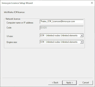

This page is used as part of the process to set up the Thales licence to be used by users on a client PC.
Enter network and licence details:
By default, this is set to NO_NET. However, you must specify the name or IP address of the Thales licence server you are using.
Click Apply to apply the settings. If the update is successful, the Finish page is displayed.
