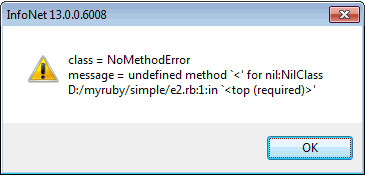

You will see the following error message:
The precise meaning of the class = NameError and the main:Object will become apparent later, but the important part of the message is 'undefined local variable or method 'badger'' and the line number of the script in which it occurred. Your text editor should have some way of showing you the line numbers. Textpad, for example, shows the current line number on the status bar, and can show the line numbers at all times if you select the 'Line Numbers' option on the View menu'. What this message means is that you are trying to do something with the value of a variable which has not had a value set. Variables come into existence when values are set for them, not when you attempt to get values from them, therefore to output the value of a variable badger without setting it is an error. It could, of course, also be that you meant to output the string 'badger' in which case you should have said the following:

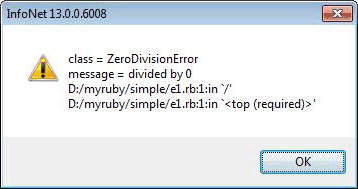

Now type the following into a file, save it as lesson3_2.r and run it:
puts 3/0
This is the error message you will see when you try to divide a number by zero.
Other error messages will be shown in due course throughout these lessons.

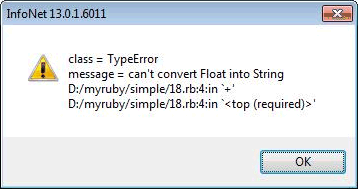

Run the script. You will see the error message:
The reason for this is that we weren't, in fact, joining strings together, we were joining 3 strings ('the x coordinate of manhole', the manhole ID and ' is ' to a number. This is not permitted by Ruby, so we must explicitly convert the number to a string by using the 'to_s' method.
Change the script by changing the final line to:
puts 'the x coordinate of manhole '+manholeID+' is '+my_manhole.x.to_s
and rerunning the script, you will see the desired output:
the x coordinate of manhole MH111111 is 278580.0

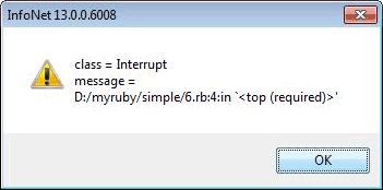

Something to watch out for is what happens should you forget to put the i=i+1 line into the script. Remove it from the script so the script now reads
net=WSApplication.current_network
manholes=net.row_objects('cams_manhole')
i=0
while i<manholes.length
puts manholes[i].id
end
Run it. You will see that the following appears on the screen and stays there:
This occurs because the script is outputting the ID of the first manhole, then checking to see if I is less than the number of manholes in the array, which it is, then outputting the ID of the first manhole, then checking to see if I is less than the number of manholes in the array, which it is, and so on and so on.
Click Cancel. You will see the error message:
This tells you that the script was interrupted before it finished. After you click OK the software may spend some time doing nothing whilst it reads the file of output messages in order to display it, which may potentially take some time.

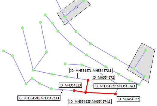

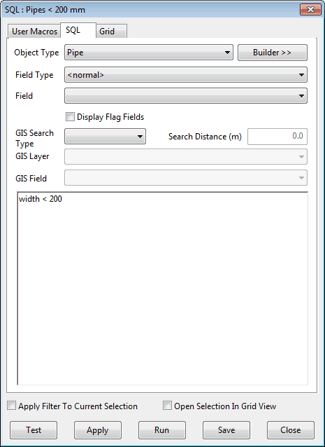

The aim now is to write a script which performs the same function as this SQL:
Type the following into your text editor, save it as lesson12_1.rb, then run it:
net.clear_selection
pipes=net.row_objects('cams_pipe')
i=0
while i<pipes.length
pipe=pipes[i]
if pipe.width < 200
pipe.selected=true
end
i=i+1
end

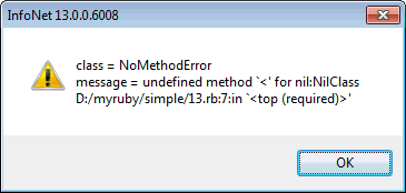

Now run the script shown above. You will see an error message as follows:
Notice that this error occurs on line 7 of the script, .which is the line that says:
if pipe.width < 200
The reason for the error message occurring is that pipe.width has the value nil for one of the pipes in the network. nil is a special value which means 'nothing', it is equivalent to NULL in SQL and serves the same purpose - to distinguish something with 'no value' from any other value such as 0, the string with no characters or false.
When a numeric field of an object in the network is blank (which is allowed in InfoAsset Manager) the value appears as blank in the grids and property sheets (and CSV export). When using the Ruby scripting in the software these field have the value nil.
If you look at the widths of the pipes in the network in a grid view you will see that there is, indeed, a pipe in the network with no value set for the field called width (which has the description US Width in the user interface).
In the SQL in InfoWorks / InfoAsset Manager, and in SQL in general, a query like width < 200 uncomplainingly ignores objects where the width is NULL (in SQL terms) and doesn't select them. In Ruby however, we cannot legitimately perform the test because the value is nil and therefore we are comparing nil with 200 which is not permitted. You can confirm this by typing the following into your text editor as a new script, saving it as lesson12_2.rb, then running it:
if nil < 200
puts 'not expecting to see this message'
end
As expected this causes the following error message to be displayed:
This is of course identical to the error message above except that the line number is different, being the first line of the script.

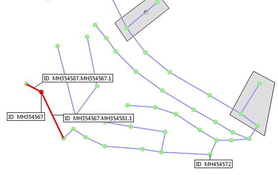

This method enables a script to be written that will select the pipes that have values of the width set where the value is less than 200. Take the script you saved above as lesson12_1.rb, edit it so it says the following, save it as lesson12_3.rb, then run it:
net.clear_selection
i=0
pipe=pipes[i]
if pipe.width.nil?
else
if pipe.width < 200
pipe.selected=true
end
end
i=i+1
end
Admire the selection of pipes and use the grids in the software to verify the correct objects have been selected.

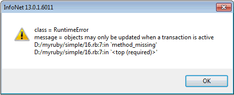

Experimentally delete the net.transaction_begin line, save and run the script, you will get the error message:
If you attempt to modify the values of objects without starting a transaction this is the error you will get.

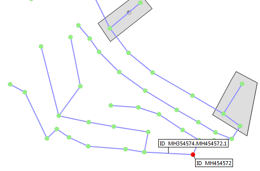

Start by selecting the node MH454572 in the example network.
The script starts by finding all the upstream links of the manhole and adds them to the array of unprocessed links. As the array started empty it now contains one link, MH354574.MH454572.1.
We now move onto the main loop, which begins:
while unprocessedLinks.size>0
The test succeeds, so the body of the loop is executed. The first line of this is:
working=unprocessedLinks.shift
This has the effect of

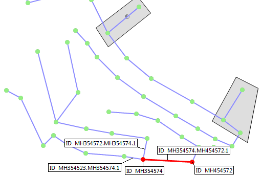

In this case, as the array contains only one link, the one we have just added MH354574.MH454572.1 this has the effect of setting working to be that link and leaving the array empty.
The link is selected, and its upstream node is testing to see if it is nil, which it isn't, therefore the node itself is selected and its upstream links are added to the array.
The two upstream links are MH354523.MH354574.1 and MH354572.MH354574.1 so they are added to the array (in that order). As the array was empty it contents are now:
[MH354523.MH354574.1,MH354572.MH354574.1]
(this is a semi-informal notation and not what Ruby would output if you used puts with the array).

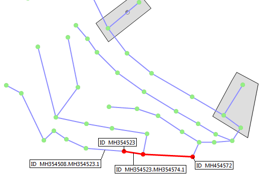

This time, working=unprocessedLinks.shift
Has the effect of setting working to the first link in the array, MH354523.MH354574.1, and removing it from the array, so the array now only contains the other one of the two links just added, i.e. MH354572.MH354574.1.
As this node (MH354523) only has one upstream link, that link is added to the working array. The working array now contains:
[MH354572.MH354574.1,MH354508.MH354523.1]
Notice that the new link is added at the back of the working array.
Once again, the end of the body of the while has been reached so the test is performed again, and again succeeded because there are two links in the array.

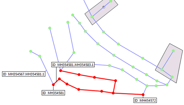

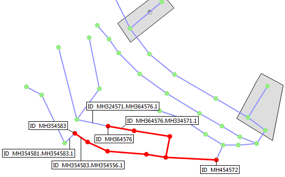

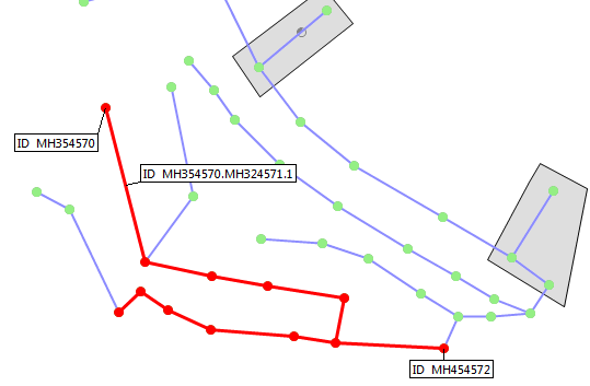

After 5 more times round the loop the selection looks like this:
In the picture above, the unprocessed links array contains the two labelled but unselected links:
[MH324571.MH364576.1,MH354581.MH354583.1]

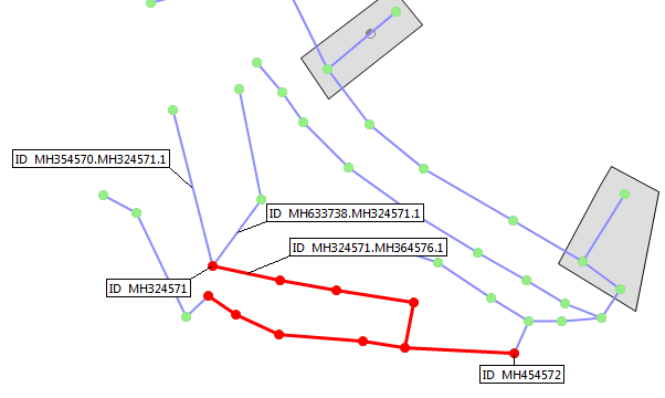

Again, the test is passed because the array is not empty, working is set to the link MH324571.MH364576.1, and the array is left containing one element, the link MH354581.MH354583.1.
The link is selected and its upstream node is tested to see if it is nil, which it isn't, therefore the node itself if selected and its upstream links are added to the array.
This time, the upstream node of the working link, MH324571 has two upstream links, MH354570.MH324571.1 and MH633738.MH324571.1. We therefore add them to the array, which for the first time in this exercise now contains three links:
[MH354581.MH354583.1,MH354570.MH324571.1,MH633738.MH324571.1]
The next time round the loop causes link MH354581.MH354583.1 to become the working link removed from the list, it and its upstream node, MH3554581 selected, and the upstream link of that node added to the array of working links.
The array of working links is now:
[MH354570.MH324571.1,MH633738.MH324571.1,MH354567.MH354581.1]
The next time round the loop causes link MH354570.MH324571.1 to become the working link removed from the list, and its upstream node, MH354570 selected.
This time, however, for the first time, the upstream node has NO upstream links, so therefore NO links are added to the working array, so the array of working links remains unchanged from the point at which the call to shift removed the link from it, so the array is now:
[MH633738.MH324571.1,MH354567.MH354581.1]

The next time round the loop causes the link at index 0 of the array, link MH354567.MH354581.1 to be removed from the array and to become the working link, and it and and its upstream node MH354567 to be selected.
The node's upstream link is added to the array of working links, which becomes:
[MH554572.MH633738.1,MH354587.MH354567.1]

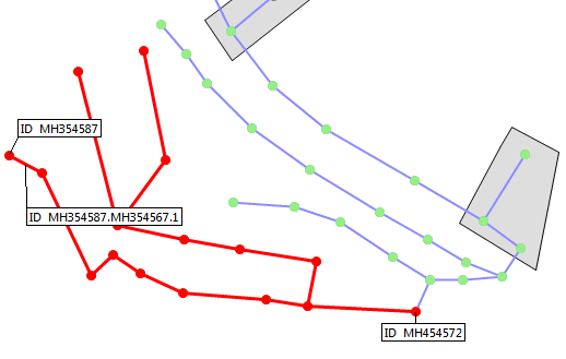

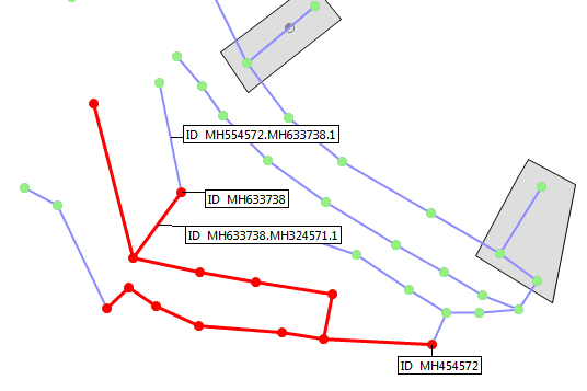

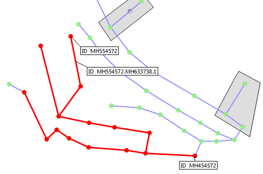

The next time round the loop causes the link at index 0 of the array, link MH554572.MH633738.1to be removed from the array and to become the working link, and it and its upstream node MH554572 to be selected.
As with the case encountered above for the middle of the three branches, this upstream node has no upstream links, therefore the array of working links remains as it was after the shift call caused the link to be removed from the array, so the array shrinks to having one element:
[MH354587.MH354567.1]
The next time round the loop causes the link at index 0 of the array, link MH354587.MH354567.1 to be removed from the array (which now has no objects in it), and to become the working link, and it and its upstream node MH354587 to be selected.
As with the previous loop, the upstream node has no upstream links, so the array remains as it was after the shift call i.e. it remains empty.
The test in the while loop therefore fails, so the execution of the script moves to the end of the while loop, so the script outputs the number of selected nodes and links and then stops.

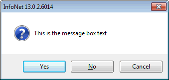

It is possible to display a variety of message boxes from Ruby scripts.
Type the following script into your text editor then save it as Lesson23_1.rb.
out=WSApplication.message_box(
'This is the message box text','YesNoCancel','?',false)
puts "got value #{out}"
Run the script, you will see the following message box:
Select the Cancel button and you will see the following output:
got value Cancel
Run it again and select the Yes button and you will see the following output:
got value Yes

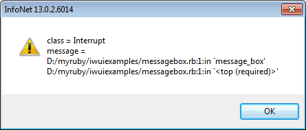

Now rerun the script but hit the cancel button. The script will be interrupted and the following message box will be displayed:
Notice that the line following the message box does not get reached so nothing is output to the output window.

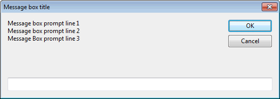

A simple way of getting input from the user is to use the input_box method.
Enter the following into you text editor, save it as lesson24.rb, then run it:
out=WSApplication.input_box("Message box prompt line 1\nMessage
box prompt line 2\nMessage Box prompt line 3",'Message box
title','')
if out.nil?
puts "cancel hit"
else
puts "OK hit, the input is #{out}"
end
The following will be displayed:

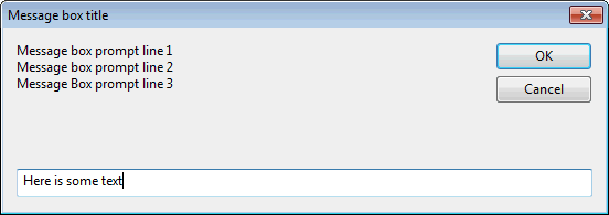

Enter some text into the text box e.g
Then click OK.
The following will be output:
OK hit, the input is Here is some text
Run the script again, but this time click the Cancel button, the following will be output:
cancel hit
The method returns the entered string if the OK button is hit, but nil if the cancel button is hit. The first parameter is the prompt text (i.e. the text that appears in the top level of the dialog), The second parameter is the window title.
