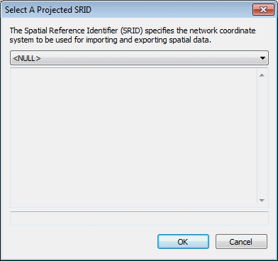

Select Oracle Projected SRID Dialog
This dialog is used when importing data from an Oracle/SQL Server database via the Open Data Import Centre or exporting data to an Oracle/SQL Server database via the Open Data Export Centre. The dialog is displayed when the Select button is clicked on the Select Oracle Data or the Select SQL Server Data dialog.
The projected coordinate system to be used when importing data from / exporting data to the Oracle/SQL Server database can be selected from the dropdown list. When selected, details of the selected network coordinate system and the SRID, for which the network coordinate system is being selected, are displayed in the information areas of the dialog.
