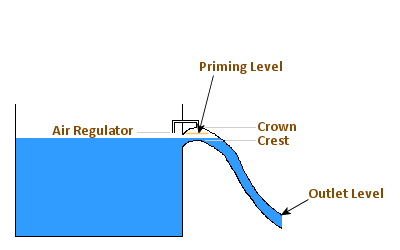

Siphon
A siphon is an overflow structure that can consist of a single siphon tube or an array of identical siphon tubes. The siphon operates very like a weir structure when the water level is less than or equal to the siphon's Priming Level. Above this level the siphon operates, hydraulically, in a very similar way to an orifice located at the siphon outfall.
Plan view of an Array of Siphons
Siphon Cross Section showing levels
See the Siphon Data Fields topic for further information.
