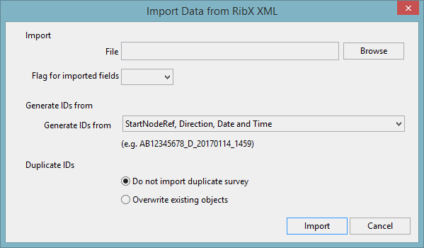

This dialog is used when importing data from RibX data transfer format files.
RibX is the XML format used in the Netherlands to exchange sewer data between a contractor and contractant.
The dialog is displayed when Import | Import CCTV survey data | Import Data from RibX XML is selected from the Network menu.
Show me
Option |
Description |
Import |
Select data to be imported:
Generate IDs from |
Set option for generating IDs:
Generated IDs are never longer than 40 characters and uniqueness is always preserved by adding an index number if necessary. |
Duplicate IDs |
Set an option for importing surveys with duplicate IDs when using the options that incorporate a time stamp:
When using the non-time-stamp ID generation options, surveys with duplicate IDs will be imported with a different suffix. Existing surveys will not be changed. |
