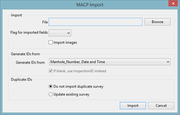

MACP Import Dialog
This dialog is used when importing Manhole Survey data from MACP format files.
It is displayed when Import | Import Manhole survey data | Import MACP manhole survey data is selected from the Network menu:
Show me
Dialog description
Section
Description
Import
Select data to be imported:
  • Browse for the data file to be imported. A standard Open dialog will be displayed. Multiple files may be selected by using the CTRL and SHIFT keys.
  • The flag selected in the Flag for imported fields dropdown will be used to flag fields containing data brought in by the importer.
  • Check the Import images box to include import of images.
Generate IDs from
Set option for generating IDs:
  • Generate IDs from: select a method for generating manhole survey IDs. Survey IDs may be generated from:
    • Manhole_Number, Date and Time: Manhole Survey IDs are generated from the manhole number, date and time values.
    • Manhole_Number, and an index if needed for uniqueness: Manhole Survey IDs are generated from the manhole number. An index is appended to duplicate IDs to preserve uniqueness.
    • the InspectionID field.
    • any of the custom fields.
  • If blank, use InspectionID instead: enabled when generating IDs from custom fields. Check this option to use the Inspection ID if the custom field does not contain a value.
Duplicate IDs
Set an option for importing Manhole Surveys with duplicate IDs:
  • Do not import duplicate survey: surveys with duplicate IDs will not be imported. These surveys will be reported in the import log.
  • Update existing survey: surveys with duplicate IDs will be updated with the current survey data.
To import manhole survey data, complete the MACP Import dialog and then click Import to import the data.
