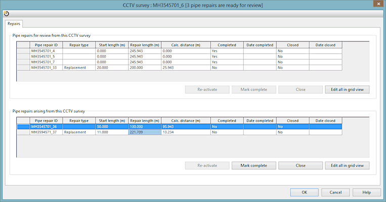

The Repairs Editor is used to view the Pipe Repair objects with which the current CCTV Survey is associated.
The editor is displayed by clicking the button from the Pipe repairs field in the CCTV Survey object properties window Property Sheet, or by displaying the Repairs page in the tabbed Property Sheet.
The pipe repair details are displayed in read only grids.
Show me
The pipe repair objects displayed in the Pipe repairs for review from this CCTV survey grid are those repairs with the Review CCTV survey ID (after) field set to the ID of the current CCTV Survey.
The pipe repair objects displayed in the Pipe repairs arising from this CCTV survey grid are those repairs with the Review CCTV survey ID (before) field set to the ID of the current CCTV Survey.
Click the Edit all in grid view button for a grid to display an editable pipe repair grid window containing the repair objects in that grid.
The following actions can be carried out on selected rows in the grid:
