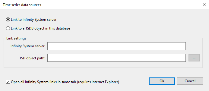

When the Link to Infinity System Server option is selected, the Infinity System Server and TSD object path fields are enabled.
Specify the name of the Infinity System server which contains the time series data to which the applicable network objects are to be linked in the Infinity System Server field. If you want to associate the objects with a particular TSD on the specified server, then enter the full path in the TSD object path field.
By default, if no TSD object path is specified, then the Infinity System searches for streams in the TSD with the path >infinitysystem>infinitysystem.
If the option Open all Infinity System links in the same tab is checked, then links will automatically be opened in Internet Explorer and the same tab updated for subsequent links. Other browsers may open a separate tab for every link.
Select OK to commit the changes or Cancel to abort the operation.

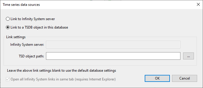

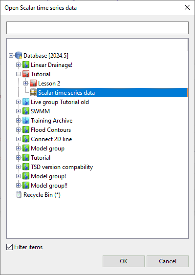

When the Link to a TSDB object in this database option is selected, the TSD object path field is enabled. To associate objects with a particular TSD object in the current database, enter the full path and name for the TSD object in the TSD object path field or click
to display an Open window, from which you can select the required TSD object.
