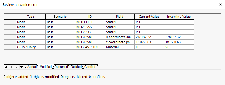

This report displays a summary of merged network objects and conflicts when you merge one network (the source network) into another network (the target network) using the
Merge changes from another network option. It is automatically generated when you click Ok in the
Merge Changes into dialog.
The objects that have been added, modified, renamed, or deleted in the target network are listed in the applicable tabs.
The report also lists the objects whose properties (Fields) have conflicting values after the merge. You can select whether to accept the Incoming Value or use the Current Value for each of the objects listed.
In the Conflict tab, the Incoming Value (highlighted in green) is applied to the target network. Clicking Undo applies the Current Value instead.
Selecting the object in the report highlights it in the
GeoPlan.
Report description
| Item
Description
| Added
| Type
The type of object that was added.
| Scenario
The scenario where the object was added.
| New ID
The object ID.
| Modified
| Type
The type of object that was modified.
| Scenario
The scenario where the object was modified.
| ID
The object ID.
| Field
The object property.
| Current Value
The object value before the merge.
| Incoming Value
The object value, applied from the source network, after the merge.
| Renamed
| Type
The type of object that was renamed.
| Scenario
The scenario where the object was renamed.
| ID
The object ID before the merge.
| New ID
The object ID, applied from the source network, after the merge.
| Details
Additional information about the change.
| Deleted
| Type
The type of object that was deleted.
| Scenario
The scenario where the object was deleted.
| ID
The ID of the deleted object.
| Conflict
| Type
The object type of the given conflict.
| Scenario
The scenario of the given conflict.
| ID
The object ID of the given conflict.
| New ID
The new object ID for the object (if applicable).
| Field
The property of the given conflict.
| Base Value
The value in the target network.
| Current Value
The value in the source network.
| Incoming Value
The value applied to the target network.
Note: Checking Undo means that the Current Value will be applied instead.
| Undo
If checked, the Current Value will be applied to the target network.
If unchecked, the Incoming Value is applied to the target network.
| Details
Additional information about the conflict.
Conflicts may arise if someone has (but not limited to):
- Renamed two objects to have the same name/ID.
- Changed the type of an object that has already been added to the target network.
