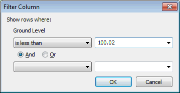

This dialog is used to set filters for which to show network objects in a network object grid window .
The dialog is displayed when the Filter option is selected from a network object / results grid window context menu. The dialog displays the name of the column the filter applies to (this is the column that has been clicked on).
A condition (or criterion) consists of a comparison operator and a value. The list of operators can be selected in the top dropdown list. The value to use for the operator can be typed in the box on the right or selected from the corresponding dropdown list (click on the
button) that is populated with a list of unique values from the column. A maximum of 10,000 values are allowed.
Up to two conditions can be simultaneously applied. The pair of boxes above the radio buttons are used to set the first condition (comparison operator + value) whereas the second condition is optional and can be specified in the pair of boxes below the radio buttons:

Once filter conditions have been set, click OK in the dialog to apply them to the grid window.
The corresponding grid window displays with the conditions being applied and a
sign in its header to indicate the presence of filtered data.
