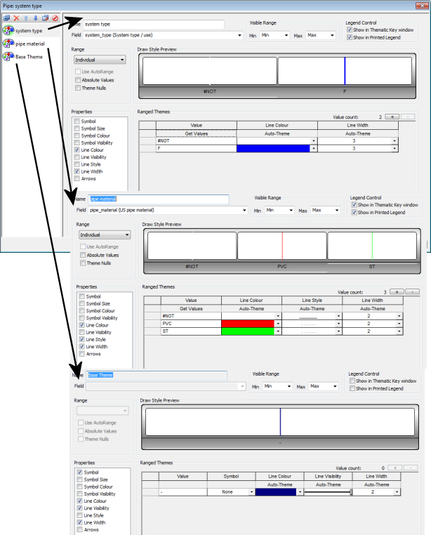

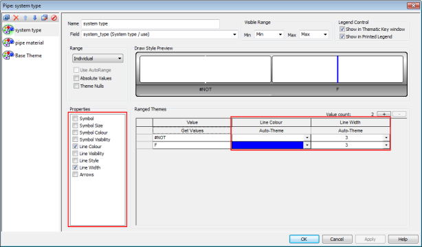

If we consider the example of 2 pipe sub-themes for system type and pipe material, for which attributes or properties are shown in the screenshot below:
For better clarity, the properties have been summarised in the table below:
Sub-Theme |
Symbol |
Line Colour |
Line Style |
Line Visibility |
Line Width |
| system type |
not set |
F (foul) - blue #NOT - white |
not set |
not set |
3 3 |
| pipe material |
not set |
PVC - red ST - green |
dotted line dotted line |
not set |
2 2 |
base theme (default theme) |
none |
Dark blue |
not set |
100% |
2 |
system type sub-theme takes precedence for the line colour and line width attributes. As no line style has been configured for system type, the next sub-theme down that has settings for this property takes precedence, which is pipe material. This means that the line style will be dotted on the GeoPlan. Similarly, as neither system type, nor pipe material have had the symbol and the line visibility properties specified, the values that will prevail are the ones of the next theme down, which is the base theme in our case (none and 100% respectively).
Now, if we look at the system type and pipe material distinction, the current setup means that all pipes of system type foul will be displayed in thick dotted blue lines, regardless of the material they are made of whilst pipes of any other system type will be shown in thick dotted white lines, also regardless of their material. This shows that the current pipe material sub-theme is not being effective at all and perfectly illustrates the property override mechanism.

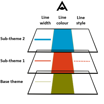

The image below illustrates how the cascading styles work if we over-simplify our example to the extreme. If we consider that each sub-theme is a transparent sheet of paper with properties on it and if we look at the superimposition of themes from the top, it can be seen that the resulting theme will have the line width and colour attributes of sub-theme 2 and the line style of stub-theme 1. Sub-theme 2 has no line style property set, therefore it is the next "visible" configuration of the line style attribute that will take precedence.
