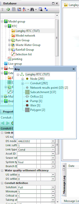

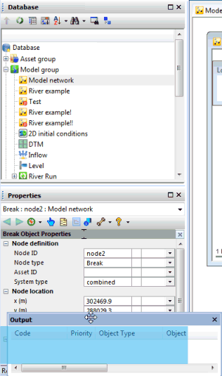

You can reposition a docking window by dragging its title bar to the desired location. If the window is already docked, starting to drag will cause it to float. If you then drag it close to the side of the application window, or over another docked window, a blue highlight will show the location at which the window would be docked.
Blue highlight showing the location where the Thematic Key Window will be docked when the mouse is released.
If this is the desired location, simply release the mouse button and the window will dock. If not, continue dragging until the highlight changes to the desired location.

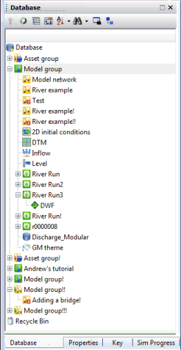

Stacked vs tabbed layout
When there is more than one window docked to the same side, those windows can be laid out in one of two ways: Stacked or Tabbed.

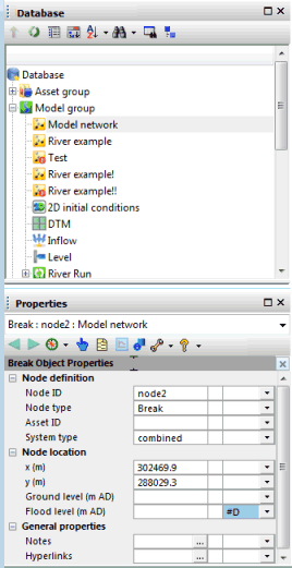

Stacked Layout
Tabbed Layout
Stacked and tabbed layouts cannot be mixed on the same side, but it is possible to have some sides tabbed and other sides stacked. The switch from a stacked to a tabbed layout is made by dragging a floating window close to the bottom of the side, as described below. To go back to a stacked layout, it is necessary to float all but one of the tabbed windows, then re-dock them in the desired layout.
Because hidden windows attempt to reappear at their previous position, if you hide a tabbed window, then set up a stacked layout on that side, the layout will switch back to tabbed when the hidden window is made visible again.
Stacked layout
The windows are arranged in one or more rows or columns along the side, each window being visible and occupying part or all of a row/column. The windows can be resized within each row/column and the height/width of each row/column can be adjusted. Each window also has a maximise/restore button next to the X button. Clicking on this causes the window to occupy as much as possible of its row or column – the other windows shrink to show only their title bars. Clicking again restores the original size. When you drag a floating window over a stacked layout, the blue highlight will show where the new window would fit into the existing layout – either within an existing row or as a new row. If you drag the floating window close to the bottom of the side, the blue highlight will appear as a narrow strip representing a row of tabs; if you then release the mouse button, all the existing windows docked to that side, plus the new window, will be forced into a tabbed layout:

Tabbed layout
Only one window is visible at a time, occupying the whole of the side. A row of tabs at the bottom of the side allows the user to switch between the different windows that are docked to that side. The order of the tabs can be adjusted by dragging an individual tab along the row of tabs. When a floating window is dragged into an existing tabbed layout at a point above the row of tabs, the blue highlight covers the whole row of tabs and the new tab will appear at the end of the row – by dragging into the row of tabs, the tab can be placed more precisely, indicated by a tab-sized highlight within the row. Tabbed windows can also be floated by dragging the relevant tab away from the row of tabs.
