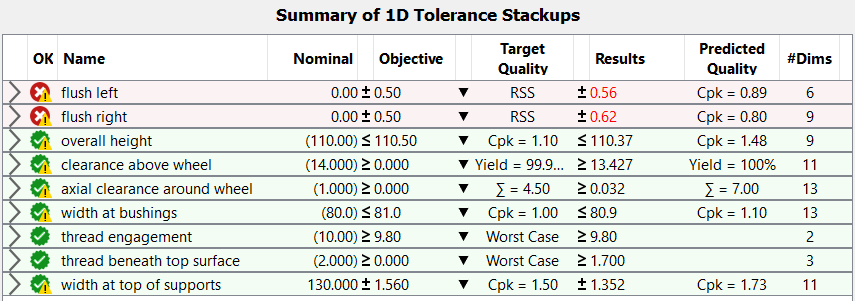

Summary of 1D Tolerance Stackups Panel
The following image is a Summary panel that displays multiple stackups. Each stackup has a user-defined name.
Right-click a stackup row in the table to:
- Edit the details of stackup. You can also select the > icon in the row to edit the details.
- Rename the stackup. You can also change the name by selecting the Name field.
- Delete the stackup. This workflow is the only way to delete a stackup.
The Summary table columns contain the following information:
- >: Click to switch to the Details panel of the selected stackup.
- OK: A check in a green circle indicates that the analysis objectives are met. An x in a red circle indicates that the objectives are not met. An exclamation point in a yellow triangle indicates that there may be 2D or 3D influence in the stackup.
- Name: An editable field that displays the name of the stackup. Tolerance Analysis names each study Stackup followed by a sequential number. We recommend that you change the name to something that describes the tolerance study.
- Nominal: The nominal distance between the selected items around which the stackup analysis is being defined. The value is shown without parentheses if it is part of the objective definition. For example, when using symmetric ± or unique +/- values to define the upper and lower limits of the objective relative to the nominal. For the other types mentioned in Objective, the nominal value is included for reference only and is shown in parentheses.
- Objective type: An unlabeled editable field to the right of Nominal that lets you choose different methods for defining the upper and lower objectives of the stackup. Because most tolerances stackups are performed to ensure clearance for fit, the default type for all new stackups is ≥ and the Objective value is 0. Click the symbol to the left of the Objective column to expand the drop-list that contains the following options:
- Objective: An editable field that lets you choose the tolerance values associated with the Objective type previously described to define the limits of the stackup results. As mentioned in the Objective type, the default objective for all new stackups is ≥ 0.
Note: Number precision is determined by the number of digits you enter in the value box. If you enter 0 without a decimal, it does not change the precision. Number placement is determined by the sign and value you enter. Tolerance Analysis evaluates the sign and value of the number to determine if it should be placed in the upper or lower segment of +/- and Limits Objective types. If no sign is entered, the sign applied to the field before the edit is restored.
- Target Quality: An editable field that lets you define the type of analysis to perform by selecting the drop-list to the left of the column. You can select the following Target Quality options:
- Worst Case: Assumes that all stackup distance dimensions included in the study are at either the extreme minimum or extreme maximum limit at the same time.
- RSS: Root Sum Squared is a statistical method for calculating the combination of dimensions based on the assumption that not all dimensions involved in the stackup are at their limits simultaneously. The key difference between this approach and the more general statistical approach described in the following section is that RSS assumes each of the contributing dimensions have the same quality level as the calculated result. Tolerance Analysis also treats assembly shift resulting from clearances between parts and datum shift resulting from material modifiers applied to datum features in a Datum Reference Frame as worst-case effects (shifted to one extreme or the other) before calculating the RSS combination of the tolerances involved.
- Statistical: Statistical is based on the same principles used for RSS analysis. The advantage of Statistical is that you can define the target quality level for the stackup regardless of what has been assumed for the part dimensions. It also treats the clearances associated with assembly and datum shifts as statistical contributors having a uniform distribution. The following metrics can be used to define the target quality level for statistical analyses:
- Results: The results of the stackup analysis based on the defined Target Quality level. The results are presented in the same format used for the Objective definition (±, +/-, Limits, and so on).
- Predicted Quality: When Target Quality is set to use one of the statistical methods this column shows the calculated quality of the stackup distribution compared to the defined Objective. For RSS, it is reported as Cpk. For the general statistical analyses Tolerance Analysis reports the Predicted Quality using the same metric type as defined for the Target Quality.
- #Dims: This column is included to quickly assess the number of dimensions contributing stackup. This is often helpful when making the determination whether to use Worst Case or one of the statistical options for the Target Quality.

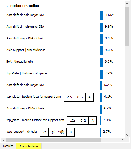

At the bottom of the Tolerance Analysis panel is the Results pane. When multiple stackups exist but none are selected, the Results pane displays a summary of the number of objectives met or not met, and a quality roll-up using the preferred quality metric specified in the Settings.
Tip: Pick empty space in the summary table to clear selected stackups.
When no stackups in the Summary table are selected and you select the Contributions tab, the pane displays a roll-up of the contributions each dimension has across all defined stackups.

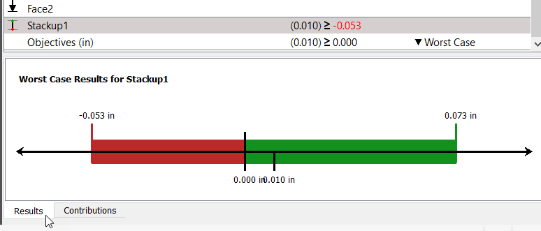

The Results graph display varies according to the defined Target Quality. The label at the top of the graph lists the Target Quality analysis type and name of the stackup.

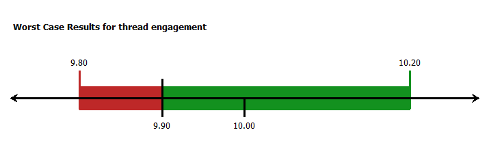

Worst Case Results
The numbers above the graph indicate the upper and lower limits and represent the stackup at the specified Quality Target. The area of the graph that is within the specification limits is shown in green and the area outside the limits is shown in red.
The numbers below the graph indicate the nominal stackup value and upper and lower specification limits for the stackup as defined in the Objective. For unilateral specifications, such as this case in which the results must be greater than 9.90, only one specification limit is shown.

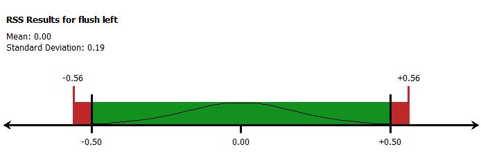

RSS Results
The RSS Results graph displays the calculated mean and standard deviation parameters for the RSS component above the graph. It also displays a normal curve which indicates the statistical nature of the analysis.
The numbers above the graph represent the upper and lower calculated RSS limits of the stackup.

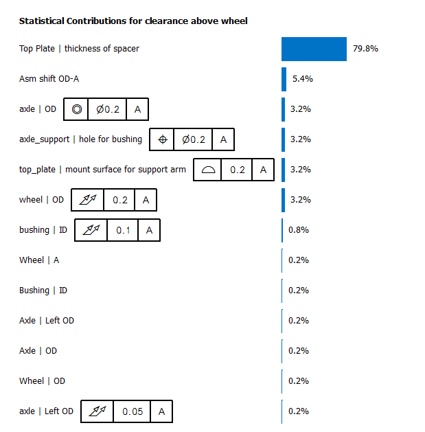

You can view the contribution of each dimension by selecting the Contributions tab at the bottom of the table to display the contributions graph. This information can help you identify which tolerance to reduce first if too much variation is predicted. The list of dimensions and tolerances that impact the stackup and their relative contribution is sorted from largest to smallest.
Each row shows one of the following:
- The part and dimension name for standard dimensions.
- The part, name of the feature being controlled, and the feature control frame including referenced datum features. In the Stackup Details table, the feature control frame is in the same row as the basic dimension between the controlled feature and the datum feature.
- Datum Shift contributors from datum features being referenced and Maximum Material Boundary (MMB) or Least Material Boundary (LMB). Included in the row is the name of the datum and the name of the feature being controlled.
- Assembly Shift contributors representing clearances between parts along with the names of the features between which the shift occurs.

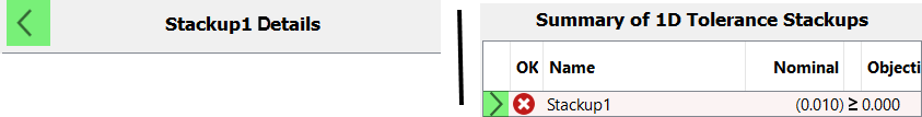

Select the > icon on the left side of the Summary table to display the stackup details.
The columns in the Details table contain the following information:

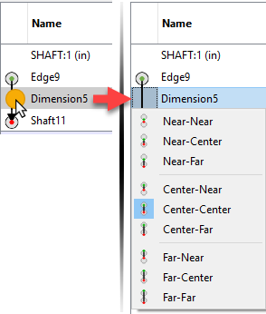

This icon represents the dimension path through the parts and features. Each feature is represented by a symbol indicating the type; a flat surface, a cylindrical feature of size, or a planar feature of size such a slot. You can change the dimension attachment for features of size located with a linear dimension or stackup measurements to or from a feature of size by selecting the line to the left of the dimension as shown in the following image.
When both the feature above and below the dimension is a feature of size, the nine options shown in the image are available. The first group indicates whether the dimension origin should be attached to the Near-Near, Near-Center, or Near-Far side of the feature immediately above the dimension. The second group is for the attachment to the feature immediately below the dimension. If only one of the features is a feature of size, there are only three options available.

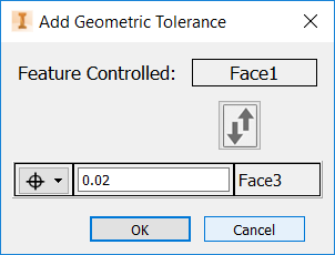

- Geometric: Defines the geometric tolerances per ASME or ISO standards. Not available for size dimensions.
Select Geometric to open the Add Geometric Tolerance dialog box. In the following image, Face1 in the top data field is assumed to be controlled by Face3 in the Feature Control Frame. If this is not correct, use the toggle control
to reverse the them.
From the drop-down at the left of the Feature Control Frame (FCF) choose the control, then set the tolerance value. In some cases you may also specify a material modifier to the feature being controlled or to the datum feature by using the drop-down list next to the tolerance or datum feature name respectively.
Use this dialog box to make modifications to the Geometric Tolerance definition. You can also change the tolerance value in the stackup Details table.
