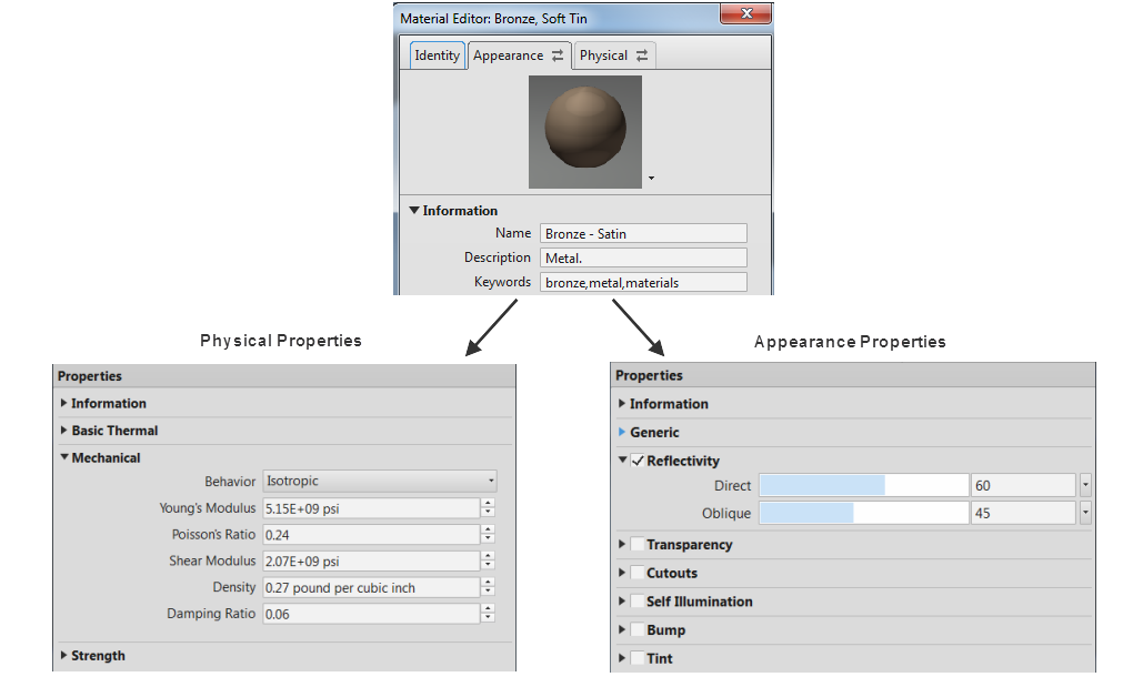

You can apply these materials to parts of a design to give the objects a realistic appearance and behavior. In some design contexts, the appearance of an object is most important, so the materials have detailed appearance properties such as reflectivity and surface texture. In other contexts, the physical properties of a material, such as yield strength and thermal conductivity, are more important, as the materials must support engineering analysis.

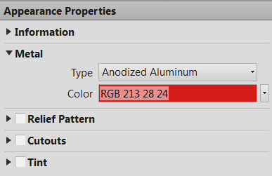

The figure shows some of the physical and appearance properties for a Bronze, Soft Tin material, as displayed in the Material Editor. The physical properties are grouped in one asset of the material, and the appearance properties in another. When you edit a material, you can change each asset independently. For example, you can change the bronze material to have a red color. Replace the appearance asset with Aluminum, Anodized Red, an asset with different appearance properties.
You can replace the physical asset for the Bronze, Soft Tin material with a physical asset that represents another metal, such as aluminum or copper. However, the changes in density and other properties result in a material with different behavior.

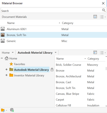

The Material Browser is used to find and manage materials. Common operations include:

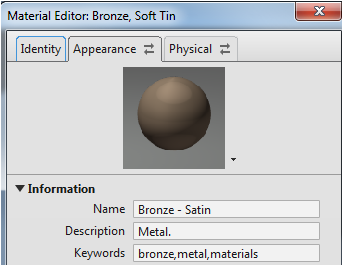

The Material Editor is used to create a material, and to review and edit the assets and properties of a material.

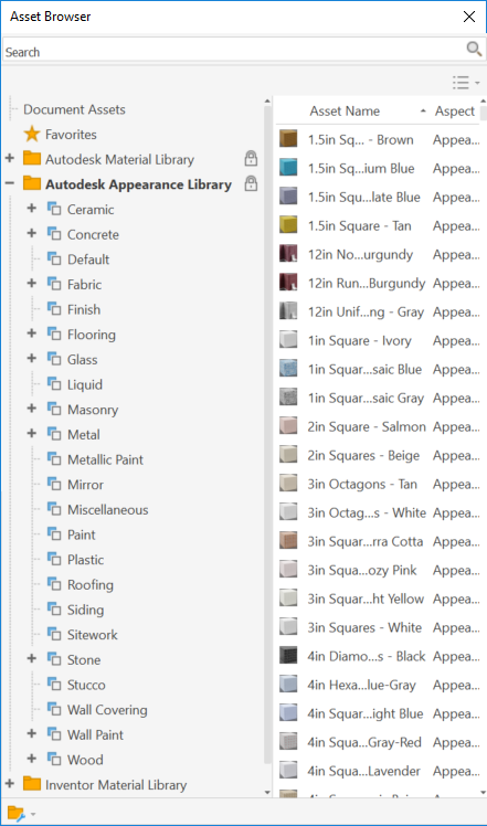

To access the Asset Browser:
To manage and review available assets, use the Asset Browser. It is useful for finding an asset to add to a material or to replace an existing asset of a material.
