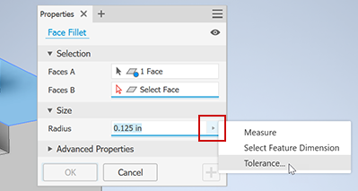

  4. Enter a radius. To apply tolerances to the fillet radius, click the arrow in the value field and select Tolerance... then, in the dialog set the desired tolerance type and value.
