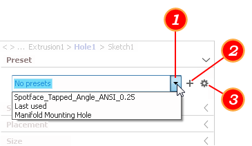

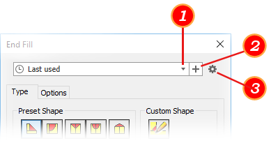

Drop down list of presets.
Creates a new preset from the current parameters. A default name is provided, but can be changed.
Preset Settings, which includes
Save Current - save the current settings to a preset you name or use the default name.

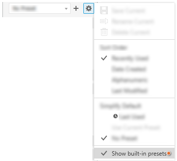

Built-in presets are predefined for the particular command. The values are based on the unit type specified in the Document Settings
Units tab. The presets are stored in dual format, metric and imperial and are read-only. There are specific rules that apply to Built-in presets when setting them as defaults.
Last Used (default preset) - when Last Used references a built-in preset the document unit settings are used. If a value is changed, these are marked by an asterisk, all values are static and no longer follow document unit settings for that action.
Use Current Preset - when a preset is designated as a default by setting Use Current Preset, the original values of the built-in preset are used and displayed using the unit type the from document unit settings.
No Preset - field values follow the document unit setting. The last used value is saved on a per document basis. If you click Apply to commit or re-start the command, the preset switches back to No Preset using the last used values and document unit settings are not applied.
New Custom Preset - you can use a built-in preset as the basis for a custom preset. Then, change only the values needed. The changed values are saved as the new preset with a reference to the built-in preset for the remaining values. Custom presets retain the unit values used and do not change with the document unit setting. When a new preset is created for features that can generate solids or surfaces, the Surface mode state is included in the preset.
Show built-in presets - built-in presets are displayed by default. They can be hidden if not used.

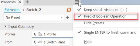

Boolean output choices are stored in the preset for Extrude, Revolve, Sweep, and Coil. For Extrude and Revolve the Advanced Setting, Predict Boolean and Direction, directs the software to suggest the boolean choice based on the profile and solids in the model. The setting overrides the preset Boolean choice.
