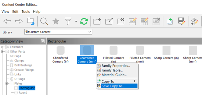

    • Open the Content Center Editor. If no documents are open, access is in Tools > Content Center > Editor. In a part or assembly document, access is in Manage > Content Center > Editor. Choose the Custom Content library, select the desired Plates family, select the end plate to receive the hole, and then right-click to select Save Copy As...

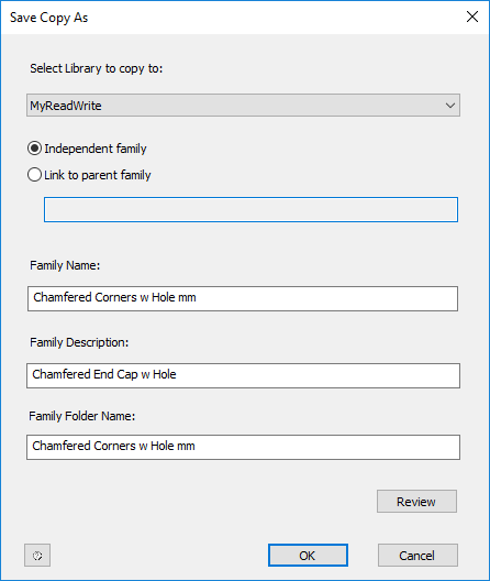

  3. Select your Read/Write library as the library to copy to, select Independent family, edit the name and description fields as required, and then click OK.

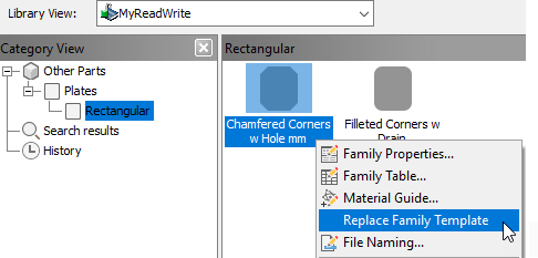

  11. Select the plate you saved in step 3, right-click and select Replace Family Template.
    Note: If you use vault to manage Content Center, you must have either a Content Center Administrator or Content Center Editor role.
  12. Browse to the location you saved the modified plate with the added hole, select the file, and click Open.
    The Publish was successful message indicates that your modified plate replaced the original copied file. Click OK and then Done to finish.
