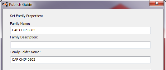

Issue: You are publishing a part using the IDF Component command and the category you want to publish to is not available in the Publish Guide - Select Category to Publish to dialog box.
Solution: To publish a part to your own category in the IDF Content Center library, create a new category under Electrical. When you publish a part to the IDF Content Center library, select the category under Electrical that you want to publish to. To learn how to create a new category see Create category in Content Center library.
