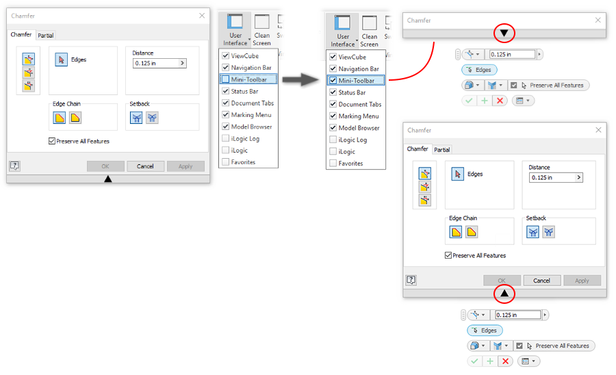

There are a few Inventor dialog boxes that have a mini-toolbar that may display alongside of the dialog box.
The available options on these mini-toolbars are the same as the dialog box options. You can elect to display or hide the mini-toolbars when you access the following commands: Shell, Face Draft, Chamfer, and Joint. By default, the mini-toolbars do not display.
To Display or Hide the Mini-Toolbars
  1. On the ribbon, View panel User Interface panel Mini-toolbar.
  2. Deselect/Select the Mini-Toolbar checkbox to display only the dialog box.
    If selected, both the dialog box and mini-toolbar display when you access one of the above commands, as shown in the following figure:
To maximize the amount of graphical space, turn off the display of the mini-toolbars.
