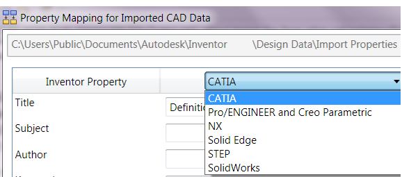

Launch the Property Mapping for Imported CAD Data tool in one of 2 ways:
Programs
Autodesk
Inventor [version]
Tools
Property Mapping for Imported CAD Data.In the Property Mapping for Imported CAD Data dialog box, click the drop down menu and select the format you want to map the Inventor standard properties to. When the Property Mapping tool is launched from the Import dialog box, the format automatically defaults to the format of the file you are importing.
Add or edit the values in a property text box as desired. Multiple values can be entered by separating them with a semicolon (;).
Click Save to save the modified property values to the updated mapping.
