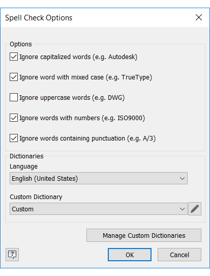

On the ribbon, click Tools tab
Options panel
Application options/General tab.
Click Options to access the Spell Check Options dialog box.
Select one or more check boxes to exclude one or more conditions from the spell check operation.
Select a language-specific dictionary to use as your main dictionary. These dictionaries install with Inventor. This dictionary is used in conjunction with the custom dictionary.
An empty custom dictionary installs with Inventor and is active by default. If you add or create new ones, click the drop-down arrow to change to a different active custom dictionary.

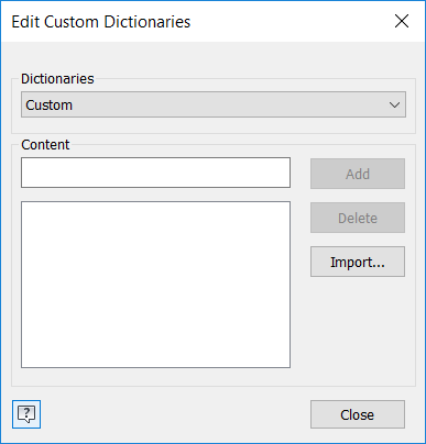

Click Edit to access the Edit Custom Dictionaries dialog box. Here you can directly add words to, or remove words from the active custom dictionary. You can also import the words in one custom dictionary and add them to the active dictionary.
- To add words: Enter a word in the Content text field and click Add.
- To delete a word: Select a word in the Content text field and click Delete.
- To import words from a dictionary into the active custom dictionary: Click Import, and then browse to the location of the custom dictionary (.cus) file whose words you want to add. Click Open to import the words.

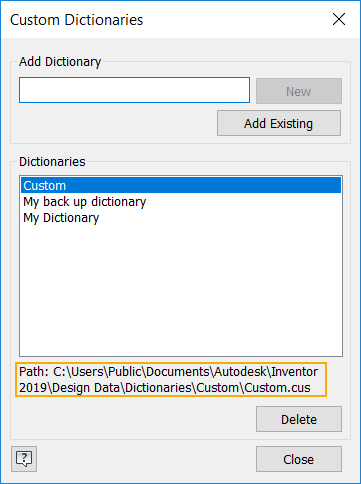

Click Manage Custom Dictionaries to access options for managing your custom dictionaries.
Create, Add Existing, or Delete Custom Dictionaries
- To add a new dictionary: Specify a name in the Add Dictionary text field and click New.
- To add an existing dictionary to your list of custom dictionaries: Click Add Existing and browse to the location of the dictionary (.cus) file you want to add. Your custom dictionaries are added to the Custom Dictionary drop-down menu in the Spell Check Options dialog box.
- To delete a custom dictionary: Select the dictionary, and then click Delete. Deleting a custom dictionary permanently removes the dictionary and the words you've added to it.
Note: The default location for the default and newly created custom dictionaries is in the Design Data folder.
