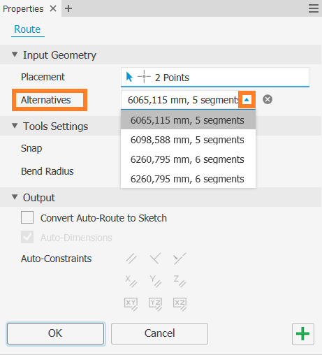

To switch to alternative auto route solutions
Once terminal geometry is defined to create an auto route region, there may be multiple solutions calculated based on length and number of segments. To display the available alternative during route creation, click the Alternatives drop-down arrow.
Note: You can also use the Select Other command to cycle through all the available solutions.
