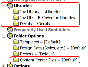

Content Center Visible: Turns on visibility of all content center components. Available only for the active view representation.
Content Center Hidden: Turns off visibility of all content center components. Available only for the active view representation.
Pack and Go does not place Content Center components in either of these locations. Therefore, those Content Center components do not respond to the visibility options.
