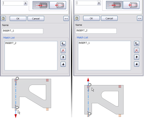

You can select a component using the Place Component dialog box, and select either Interactively place with iMates or Automatically generate iMates on place. If at least one component is already placed in the assembly, iMates are matched. You can increase the accuracy of the results by creating a Matching List.
Creates an iMate name. You can enter a name or leave blank and a default name is automatically created.
Creates a list of iMate names. When a component is placed, matching first attempts to find a name in the list, and then to match iMate properties.
Adds a name. Click it and then enter a name.
In this example, multiple instances of a component are assembled in ladder form. To accomplish it, an iMate matching list is created so Post 1 is always placed into Hole 2.
