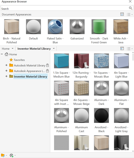

Appearance Browser
The Appearance Browser provides access to create and modify the appearance assets within the document, and to access the appearances located in the available libraries.
