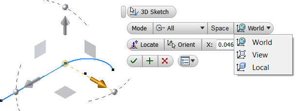

Reposition 3D Sketch Entities With 3D Transform
Start the 3D Transform command and then select one or more 3D Sketch entities to edit.
  1. Click 3D Sketch tab Modify panel 3D Transform .
  2. Optionally, select a transform Mode:
    • All. All manipulators are available.
    • Translation. Only translation manipulators are available.
    • Rotation. Only rotation manipulators are available.
  3. Optionally, select a Space mode:
    • World. Orients the manipulator with the model origin.
    • View. Orients the manipulator relative to the current view of the model.
    • Local. Orients the manipulator relative to the selected objects.
  4. Optionally, select Locate to relocate the triad.
  5. Optionally, Select Orient to reorient the triad.
  6. Enter precise X, Y, Z, or angular values or free drag to move the selection.
  7. Click OK to finish.
