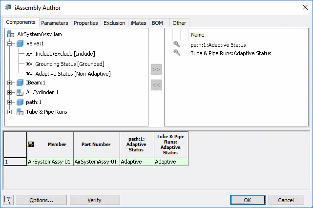

File name of the primary runs assembly is displayed in the candidate objects list, by default, Tube & Pipe Runs. The adaptive status is automatically selected into the configuration table.
Optionally, click Name to customize the part number and member name for assembly configuration. In this exercise, use the default naming schema.

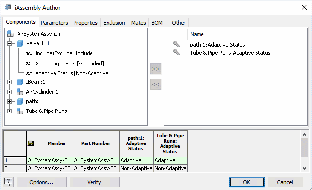

In the configuration table, right-click a row number and select Insert Row.
A new configuration is created, AirSystemAssy-02. By default, the primary runs assembly is non-adaptive as indicated in the Tube & Pipe Runs: Adaptive Status column.

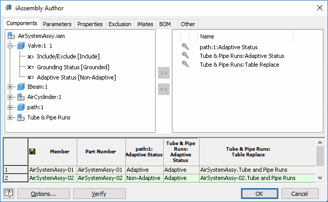

Table Replace column is added to the configuration table.
The tube and pipe interchangeability set is initiated with two primary runs assembly members so it can be swapped in for the desired configuration row using the Table Replace drop-down list.
Repeat Step 6 through Step 12 to add more configuration rows and include more adaptive primary runs assembly members into the tube and pipe interchangeability set.
Optionally, to swap in another tube and pipe interchangeability set member for one configuration, click the appropriate Table Replace cell and select a specific primary runs assembly.
