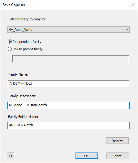

    • Open the Content Center Editor. This is located in Tools > Editor if no documents are open, and in Manage > Editor in a part or assembly document. Select the structural shape family, right-click to select Save Copy As...
  3. Select your Read/Write library as the library to copy to, edit the family name and change the descriptions as required, and then click OK.
