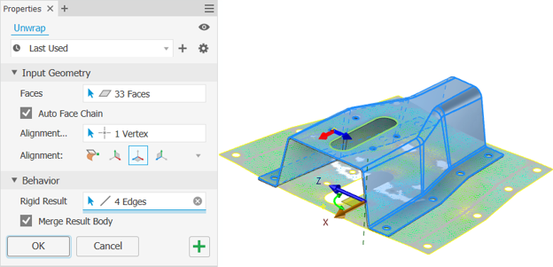

  4. Faces: In the graphics window, select one or more contiguous faces.
    • Auto Face Chain: Enable face chain to select multiple faces with one pick.
    • Alignment... Unwrap uses the vertex closest to your selection when select the face to Unwrap. In an origin plane alignment, the assigned vertex is positioned at the 0, 0, 0 Center Point. Clear the vertex selection to choose a different vertex.
    • Alignment:
      • Align to Model: Places unwrapped surface in the same orientation as the model.
      Note: When you orient the surface using an origin plane, you can use manipulators in the display to reposition the output surface and the vertex displays direction indicators.
      • Align to XY Plane: Places the unwrapped surface at the origin and in the same orientation as the XY plane.
      • Align to XZ Plane: Places the unwrapped surface at the origin and in the same orientation as the XZ plane.
      • Align to YZ Plane: Places the unwrapped surface at the origin and in the same orientation as the YZ plane.

    • Linear Result: Enable to select one or more contiguous edges to remain straight.
    • Rigid Result: Enable to select one or more edges to remain rigid. For example, select coplanar holes to maintain spacing when unwrapped.
  2. Merge Result Body: Enable to create the output as a single surface face. Disable to create a single surface with multiple faces.
Note: The surface preview displays a surface mesh and heat map. The heat map shows areas of low deformation and tension as blue and areas of high deformation and tension as red. After creation, edit the unwrap feature to view the heat map.
