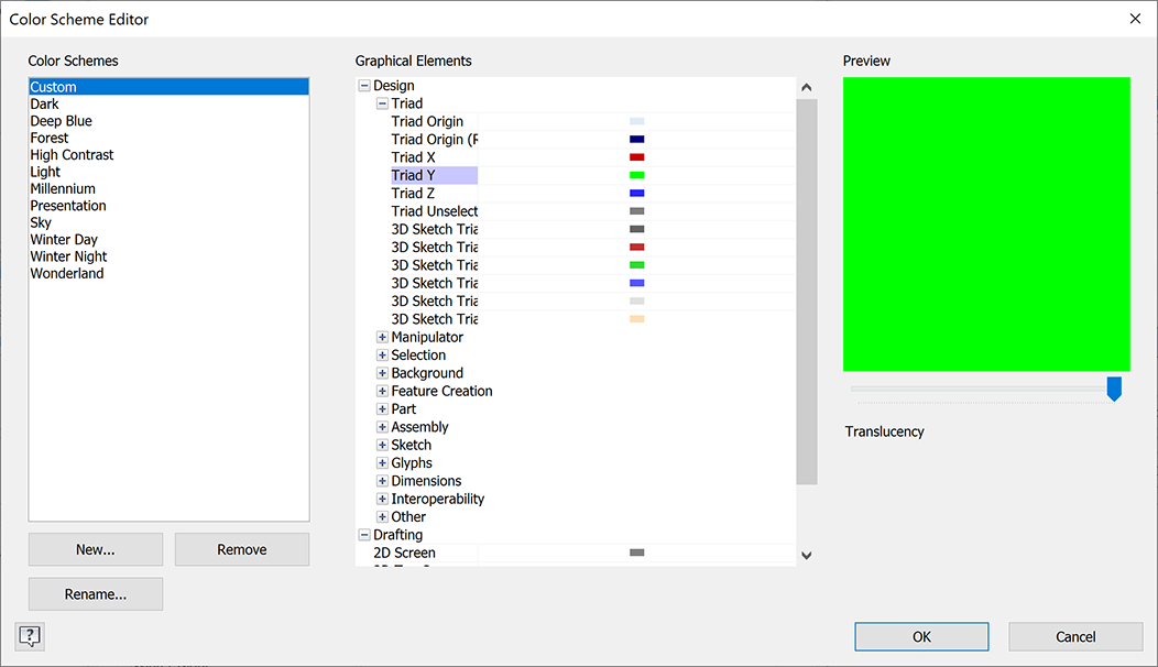

Use the Color Scheme editor to customize the color schemes of the graphical elements used in Inventor.
What's New: 2022.1
Highlight a graphical element:
Under Color Schemes, highlight a custom color scheme:
Click New to create a new color scheme.
Click Remove to remove the selected color scheme.
Click Rename to change the name of the selected color scheme.
Restart Inventor to use the new settings.
