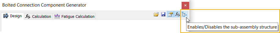

By default, the sub-assembly structure is disabled, and the bolted connection parts are created at the root level of the assembly. You cannot enable Automatic solve using this structure. You must use Manual solve to update the bolted connection.
Enable the sub-assembly structure to create a sub-assembly containing the bolted connection parts at the root level of the assembly. Prior to Inventor 2021, this was the only option for creating bolted connections. Use this option if you want to enable Automatic solve.
