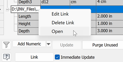

  4. To open the linked file, right-click the filename-path in the Parameters dialog and click Open.
