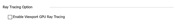

To use GPU mode do the following:
  1. Go to Tools Options and click Application Options.
  2. Click the Hardware tab.
  3. At the bottom of the dialog, select Enable Viewport GPU Ray Tracing. If the hardware is compatible, the option is available.
    Note: See GPU Ray Tracing below for information about the dialog.
