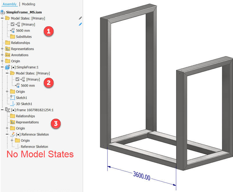

In the following image, the model states in SimpleFrame_MS (1) consume the sketch dimensions specified in the active model state of SimpleFrame (2).
The system-generated frame assembly Frame 160798... (3) uses the sketch named Reference Skeleton to control the current layout. Reference Skeleton is a copy of the sketch geometry in SimpleFrame. Because model states are not allowed in the system-generated frame file, the Frame Reference Skeleton sketch always reflects the dimensions specified in the sketch of the currently active model state of SimpleFrame:1.
Because Frame cannot synchronize with a specific model state, there are multiple solutions when one is expected. This results in unexpected changes in the assembly and drawings created from the assembly.
