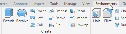

Access Environments Within Part File
In a Part file, on the ribbon, click the Environments tab.
Click one of the available environments.
- Inventor Studio
- BIM Content
- Stress Analysis
- Dynamic Simulation
- Cable and Harness
- Tube and Pipe
- 3D Print
Note:
- Dynamic Simulation, and Stress Analysis are available in both the Autodesk Simulation products and Autodesk Inventor.
- Cable and Harness, and Tube and Pipe are available only in Autodesk Inventor.

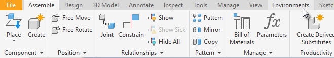

Access Environments within Assembly File
In an assembly file, on the ribbon, click the Environments tab.
Note: Dynamic Simulation and Stress Analysis are available in both the Autodesk Simulation products and in Autodesk Inventor Professional. Cable and Harness, and Tube and Pipe are available only in Autodesk Inventor Professional.

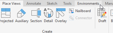

Access Environments within Drawing File
