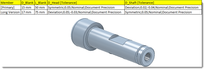

Right-click the Model State to edit and select Edit Table.
Optionally, right-click a model state in the browser and select Edit via Spreadsheet to edit the table in Excel.
