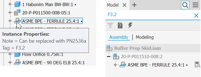

Instance Properties commands in the component context menu
Instance Properties browser commands are available only in context of the parent assembly. Multi-selection of component instances is supported.
Instance Properties creates or edits instance properties for the selected component instance.
Delete Instance Properties deletes all instance properties from the selected instance.
Instance Properties dialog box
Displays, adds, edits and deletes instance properties.
- A tooltip shows instance properties assigned to the component instance.
- A dot mark next to the instance name marks instances with instance properties.
- Instance properties are supported in browser search.

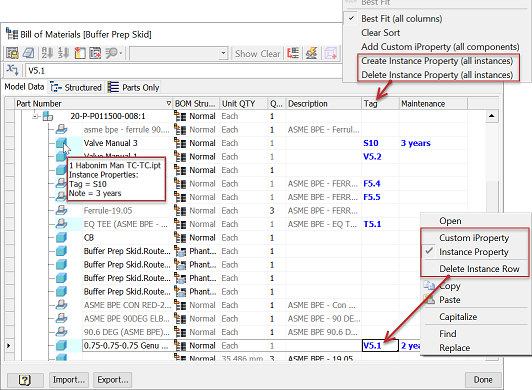

BOM dialog box
Displays, adds, edits, or deletes instance properties.
- The icon field for an Instance property row has a cyan background.
- Instance property values are blue.
- Tooltip lists instance properties assigned to the instance.
- Use the context menu to work with instance properties.
- Model Data tab separates all instance property rows. Other tabs show or merge instance rows based on Merge Instance Rows option in the Part Number Row Merge Settings dialog box.
