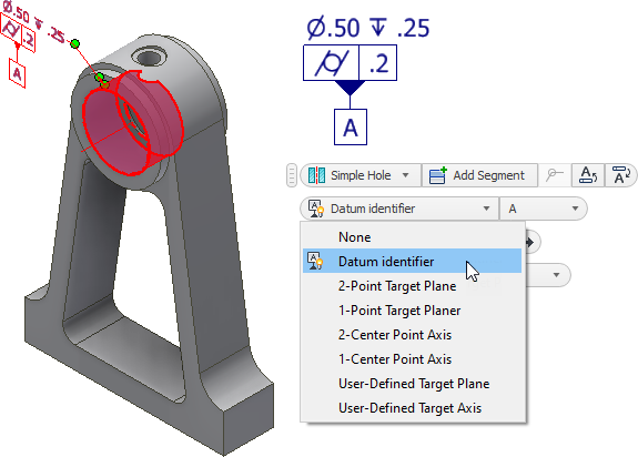

    An interactive preview of the tolerance annotation is attached to the minitoolbar. The minitoolbar includes options to select type of geometry or feature, attach a datum identifier, or add a row to the feature control frame. Options suitable for the selected geometry or feature are displayed in the list boxes.
  4. Click the elements on the preview to edit properties and values displayed in the annotation. Click the Datum identifier drop-list to view the options.

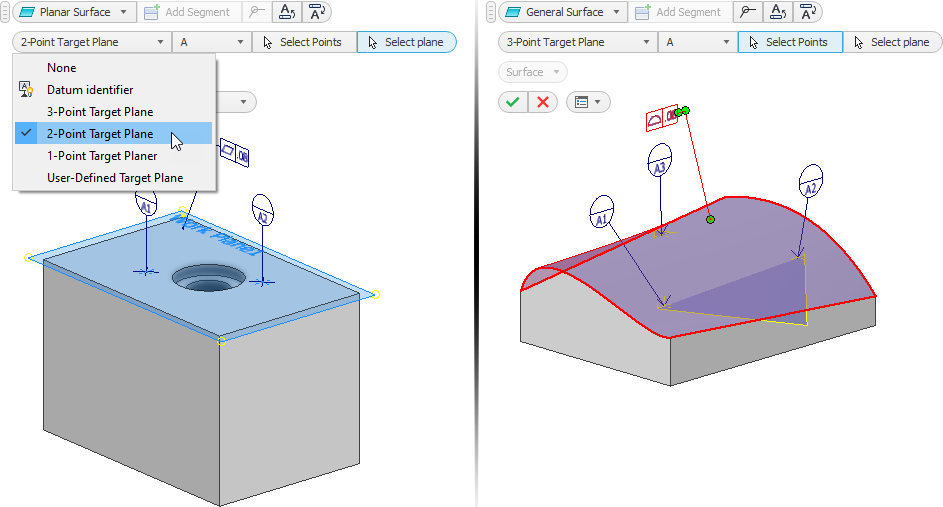

    • You can create Datum Targets by choosing one of the options in the drop-list. For example, the following image on the left creates datum targets using two 2D Sketch points and a work plane. The image at right uses three work points and a work plane.
      Note: 2D Sketch points are automatically selected. You must select work points manually.

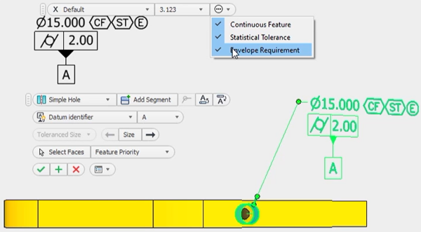

Add Continuous Feature, Statistical Tolerance, and Envelope Requirement symbols
Use the annotation options to append feature modifiers directly to the dimension text. The feature modifiers display in the order in which you add them.

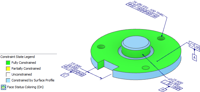

The Tolerance Advisor guides you through creating a fully constrained model. When you create tolerance features, the advisor displays informational messages or warnings about potential issues in the Tolerance Advisor browser pane. Enable Face Status Coloring to view the constraint state of the model faces.

  5. Optionally, click Face Status Coloring at the bottom of the Tolerance Advisor browser to enable or disable face constraint state coloring.
