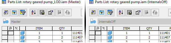

What is BOM delegation?
The BOM delegation message appears when you start the Parts List command and the model state of the selected view meets one of the following conditions:
- The model state is a migrated non-Master Level of Detail.
- The model state is a migrated substitute part LOD.
- The model state is a substitute part file.
The parts list for a model state created from a migrated non-Master LOD uses the Master model state Bill of Materials. The parts list for a substitute created from a migrated LOD substitute also uses the Master model state BOM. The parts list for a substitute uses the model state BOM of the source assembly.
