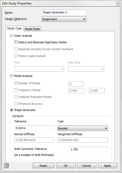

  2. On the ribbon 3D Model tab Simulation panel, click Stress Analysis. The Stress Analysis environment can also be accessed from the Environments tab.
  3. On the Analysis tab Manage panel, click Create Study.
  4. In the Create New Study dialog, select Shape Generator and click OK.
