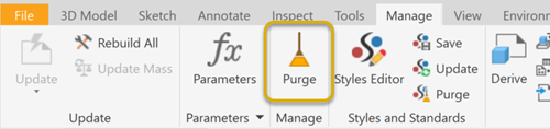

When designing you can end up with work features and sketches that are no longer used. This extraneous data can be selectively removed using the Purge Unused command.
In either the Part or Assembly environments, access the Purge Unused command from:
The ribbon Manage tab
Manage panel
Purge Unused
