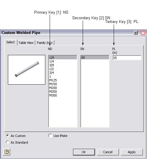

Pipe iParts typically have three family key columns: nominal size, schedule number, and pipe length. For the sample pipe iPart:
Fitting iParts typically have one family key column: nominal size. For the sample elbow iParts, on the Other tab, NPS is primary key {1}.
The following image illustrates the relationship between iPart family key columns and part family thumbnail page in the Content Center.
Family key columns play an important role in the file naming schema for part families in the Content Center. After authoring and publishing, the sequential combinations of hierarchical keys form the value of the pre-defined property in the Content Center. In this case, {DESIGNATION} is pipe {NS} {SN} {PL}, in which pipe indicates the conduit part type.
