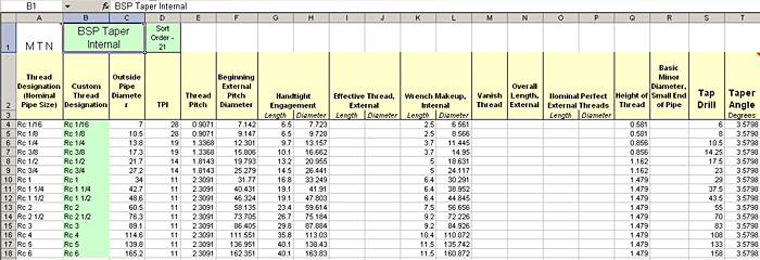

- T indicates that the worksheet contains taper threads. All taper worksheets must have this character.
- X indicates that the worksheet contains only external thread data. X or N can be used. When X and N are omitted, the worksheet is available for external and internal.
B1/C1 | These merged cells contain the custom thread type name that appears in the dialogs. Unlike the name on the worksheet tab, you can customize this thread type name to satisfy language or company differences without affecting the ability to exchange design data. |
D1 | This cell contains the sort order number, which is used to determine the thread type list order in the dialogs. The number does not have to be sequential. A lower number places the thread type above those with higher sort order numbers. |
The area containing thread data begins on the fourth row. The following lists each column and its contents:
A | Specifies the thread designation, also known as the nominal size of the thread. It is a key for identifying thread selection. |
B | Specifies the custom thread designation, which can be useful in obtaining correct thread callouts in drawings. |
C | Specifies the outside pipe diameter. |
D | Specifies the threads per inch (TPI) value. |
E | Specifies the pitch distance, which is the distance from a point on one thread to a corresponding point on the next thread, measured along the thread axis. |
F | Specifies the beginning value of the external pitch diameter. |
G | Specifies the handtight engagement length, which is the normal length of engagement between external and internal taper threads when screwed together by hand. |
H | Specifies the pitch diameter at a handtight engagement position. |
I | Specifies the effective external thread length. |
J | Specifies the effective (pitch) diameter of the external thread at the large end. |
K | Specifies the wrench makeup length of the internal taper thread. |
L | Specifies the pitch diameter of the small end of the wrench makeup length of the internal taper thread. |
M | Specifies the vanishing length of the external taper thread. |
N | Specifies the overall length of the external taper thread. |
O | Specifies the length of the nominal perfect external taper thread. |
P | Specifies the pitch diameter of the nominal perfect external taper thread. |
Q | Specifies the thread height. |
R | Specifies the basic minor diameter at the small end of the pipe. |
S | Specifies the tap drill diameter for the internal taper thread. |
T | Specifies the taper angle, in degrees, as an included angle. |
