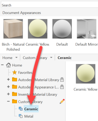

  4. Click Save. The library is visible in the Library list in the lower section of the Appearance Browser.
  5. Decide whether or not you will organize your library using categories. To create a category:
    Right-click the new library in the lower left pane and click Create Category and then name the Category.
  6. From the Document Appearances section, drag and drop all appearances you want to keep into the custom library. You can drop them on category nodes or on the library node.
