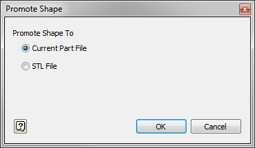

To Promote the Shape to the Part
Save the reference shape for use in modeling environment or add it to the current part.
When the simulation is complete, you will see the newly generated reference shape. If you are happy with the resulting geometry, use Promote Shape on the Analysis tab Export panel to save the geometry and return to the modeling environment.
There are two options available for promoting the generated shape:
Promote Shape saves the reference shape in STL format. We can overlay the reference shape on the original design to understand where excess material can be removed.
