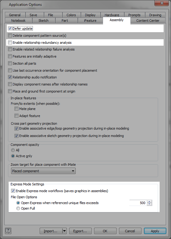

Learn which settings can be optimized for large assembly performance.

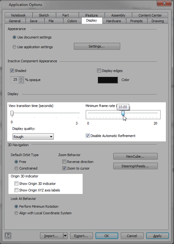

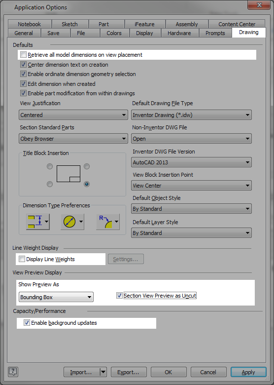

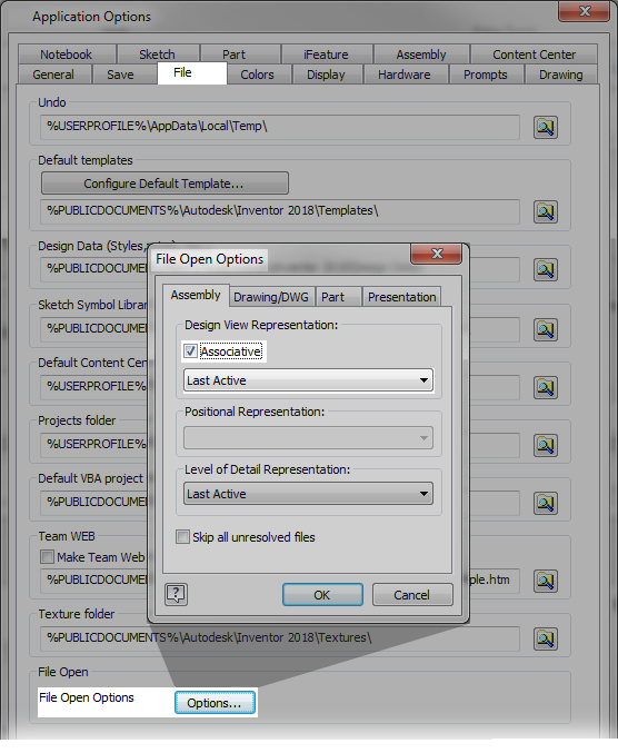

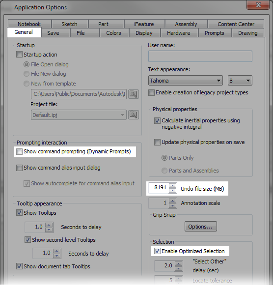

The following are Application Options that affect assembly performance.
Performance - on
Note icons - off
Autoproject edges for sketch creation and edit - unchecked
For more information: Application Options settings.

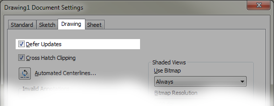

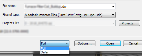

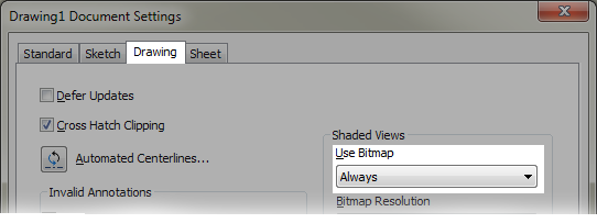

Large Assembly Drawings can take time to open as all components or parts are checked for updates. You can defer the update process when opening a drawing by selecting Defer in the Open dialog box.
You can also set an open drawing to a deferred state. In the ribbon, click the Tools tab and in the Options panel click Document Settings. In the dialog box, click the Drawing tab and check the box next to Defer Updates. Views will not be updated with model changes until this setting is turned off or overridden when opening the drawing.
Active Document
If you are working in a drawing and want to turn on Defer Updates, right-click the top level drawing node in the browser and click Defer updates.
For drawing templates, specify the use of bitmaps for shaded views rather than 'Offline Only' during viewing operations.You can do so by opening the Standard.idw drawing template and Save As "Large Assembly Standard.idw." In the Tools tab > Options panel click Document Settings. On the Drawing tab, in the Shaded Views section, set Use Bitmap to Always. Save the changes.
