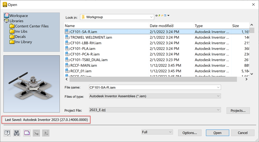

Use the Open or Place command to create a reference the newer version of an assembly file:
Open.
Component panel
Place.Browse to and select the newer assembly file (.iam) to open.
Optionally, click Options to open the File Options dialog box and specify the specify the Design View and Positional Representation. Click OK.
In the Place Component dialog box, click Open. Solid and surface bodies are created.

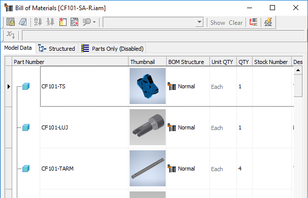

Bill of Materials displays the referenced components in the assembly.

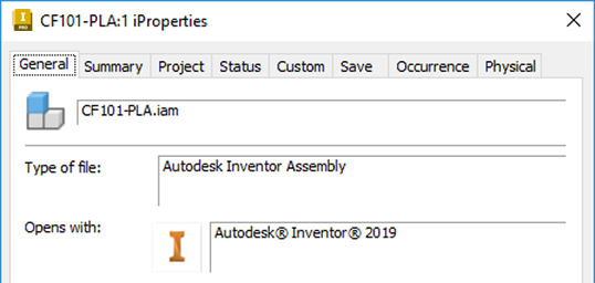

iProperties of the newer parts are available.
The assembly can be saved and reopened by any installation of Inventor of the same version.

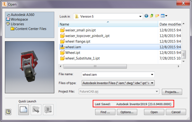

Optionally, click Options to open the File Options dialog box and specify the Design View and Positional Representation. Click OK.
In the File Open dialog box, click Open. Solid and surface bodies are created.

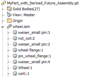

The browser displays the referenced newer file.
The derived assembly feature is editable.
