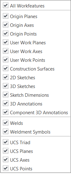

To set visibility using the Object Visibility command
The view controls available in the Object Visibility command enable or disable the visibility for all instances of the selected elements.
  1. On the ribbon, click View tab Visibility panel Object Visibility.
  2. On the drop-list, clear the check mark to turn off visibility, select the box to enable visibility.
Note: It is possible to have conflicting visibility states. For example, if you turn off the visibility of a work plane using the context menu option, it is not visible when you enable work plane visibility in the Object Visibility drop-list. If you experience a conflict, enable the element in Object Visibility and then check the status in the browser.
